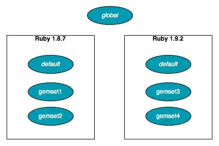

Now, each Ruby version normally has a couple of Gems installed (Rails being one). Think of it as a plug-in. In the normal case, you only have one set of plugins for the Ruby on your system. With RVM however, you can configure it to use multiple "Gemsets" per Ruby version. Thus, you can use multiple Ruby versions (e.g. Ruby 1.8.7 and 1.9.2) and have each of them use different Gemsets.
In your case, maybe you want to have two Gemsets for each of your versions:
In addition to Gemsets you create, each Ruby also has a "default" Gemsets. This is the one you get when you don't supply any Gemset name while switching. All of them share one "global" Gemset as well.
