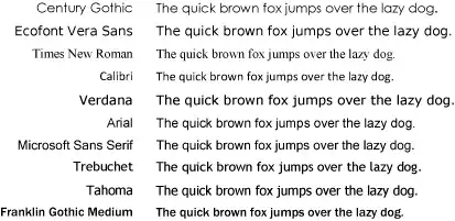

University of Wisconsin Green Bay changed to Century Gothic, which they claim uses roughly 30 percent less ink when printed on paper. Here's an article on the University change.

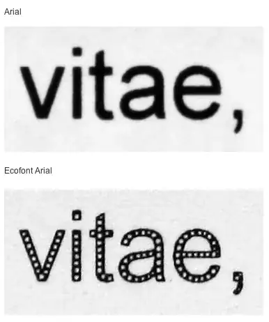

Folks at Ecofont say theirs saves more. Looks like a bit of a debate but ongoing research might find a winner.
Here is an EcoFont comparison with other well known fonts.
Here are Arial and EcoFont compared:
