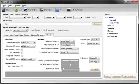

  • Please post your *exact* Handbrake settings (i.e. the ones under "Advanced"). Can you describe what is "worse" about them? Do they look blocky? Noisy? Blurry? – slhck Sep 30 '11 at 12:30
  • http://imgur.com/z6w7w I didn't change any of this from the default as I don't know what any of it does really. "Worse" is overall blurry and with anything time there is a scene with anything moving fast, like the opening credits of Dilbert (the last show I encoded), would cause the image to go blocky or noisy. – jonathanwash Sep 30 '11 at 12:45
  • Have you tried encoding using the two-pass option? Animated content is [hard to encode](http://x264dev.multimedia.cx/archives/102), and usually those people that offer rips spend a lot of time fiddling around with the settings. If you have fast motion, use higher values for "reference frames" (as the tooltip says). You can then also try to set the motion estimation to "Uneven Multi-hexagon" and see if that works. – slhck Sep 30 '11 at 14:03
