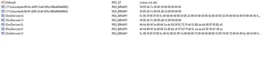

Does anyone know what "\?\Volume...." is or why it would be listed as a disk on the windows defragmenter?

The E: and F: drives are mirrors.
Listing for HKEY_LOCAL_MACHINE\SYSTEM\MountedDevices\ . There were many other entries with similar naming but they were removed after using the application suggested by Psycogeek.
reg
I removed the keys as Psycogeek suggested but they repopulated as a different alphanumeric string labelled as "Never run"

  • It doesn't show up on the drive but it is listed in the registry under.. HKEY_CURRENT_USER\Software\Microsoft\Windows\CurrentVersion\Explorer\MountPoints2\CPC\Volume\{e4c9fcfe-d20f-11e0-93fa-806e6f6e6963} , HKEY_LOCAL_MACHINE\Microsoft\Dfrg\Statistics\Volume{e4c9fcfe-d20f-11e0-93fa-806e6f6e6963} , HKEY_LOCAL_MACHINE\SYSTEM\MountedDevices\ and HKEY_USERS\S-1-5-21-199.......\Software\Microsoft\Windows\CurrentVersion\Explorer\MountPoints2\CPC\Volume\{e4c9fcfe-d20f-11e0-93fa-806e6f6e6963} – Riguez Oct 02 '11 at 19:19
  • I assume that if I delete the key listed under HKEY_LOCAL_MACHINE\SYSTEM\MountedDevices\ which has the exact same name and reboot it will disappear... would still like an explanation of why it would show up under defragmenter like it does. – Riguez Oct 02 '11 at 19:42

  • Nothing is connected.. I deleted the keys and it recreated them with a different string as shown in the screenshots – Riguez Oct 03 '11 at 03:11

  • I ran the program and it removed records of a large number of devices including the one listed but the volume is not only still listed under the windows defragmenter but it is also still listed under HKEY_LOCAL_MACHINE\SYSTEM\MountedDevices\ ... there were like 30 entries under this with similar names but the application removed them and left it alone along with one other similar key. – Riguez Oct 02 '11 at 20:36
  • dang, that leaves chuck it and reboot and see if it comes back. i have not got that far with win7, but none of the locations you point it at are critial, it is not in my system, and it was not in the microsofts MVP system when he showed his. – Psycogeek Oct 02 '11 at 20:47
  • **Listing for HKEY_LOCAL_MACHINE\SYSTEM\MountedDevices\** **This looks very bad to remove those , from that location.** Ohh crud, i think you could lose boot. – Psycogeek Oct 02 '11 at 21:13
  • I deleted all the registry keys that had the string in it and rebooted.. but the keys were repopulated with a different string and the entry is still listed under the defragmenter. I edited the OP with a screenshot. – Riguez Oct 02 '11 at 21:24
