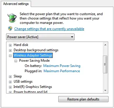

Now let's look at Power Settings:
The inner frame of the Power Settings window's Advanced Settings tab, with the section Wireless Adapter Settings expanded.
I would like to know what impact the selected options have on Wi-Fi.

As for the power settings, it changes the amount of power the network card use. So, as you configured it for battery it would go into a lower power state; when on battery this could result in less reception, less stronger output signal, less throughput and so on...

Also, I believe the Power Saving Mode setting inside the Power Settings is just a way to change the "Power Save" setting in this list of advanced settings.
The Power Save Mode property is used to put the wireless client computer into the IEEE 802.11 Power Save mode. When the Power Save Mode property is enabled, the radio is periodically powered down to conserve power. When the radio is in Power Save Mode, packets are stored in the wireless router/AP until the radio comes on. The Fast setting allows full throughput with power savings.
