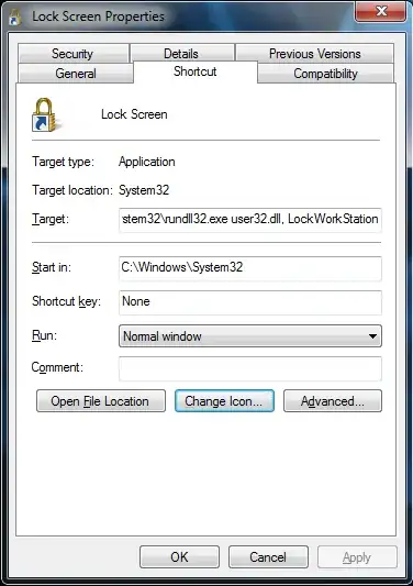

If you wish to lock your computer via a shortcut, then setup a shortcut like this.
  • Filename: Lock Screen.lnk
  • Target: C:\Windows\System32\rundll32.exe user32.dll, LockWorkStation
  • Icon path: %SystemRoot%\System32\shell32.dll
  • Icon Index: 47
You can even assign a shortcut key to the shortcut if you want.
lock shortcut

  • Expanding off Zoredache's answer, you could just create a shortcut directly to the screensaver. This would trigger the screensaver, and if you wait longer than the idle time you set for your screensaver, the computer will be locked should you try to return. The smallest keystroke combination you can use is 3 keys with this method, as far as I know. – stoicfury Oct 08 '11 at 00:44
    -1 for trying to reinvent the wheel. Windows+L has done this since XP. – ThatGraemeGuy Oct 08 '11 at 05:21
    @Graeme Donaldson, I support a large number connecting to a terminal server. They don't have a Windows button to press. A portion of this large number of users also borders on technically illiterate, but they must be able to lock their computers. A shortcut on the desktop and pinned to the start menu and task bar make this easy for them. Also, not everyone likes to or is able to memorize a large number of keyboard shortcuts. The question also explicitly asked how to trigger via a desktop shortcut, I was simply answering the question that was asked, so I don't get the downvote. – Zoredache Oct 08 '11 at 19:27
  • You can lock from the Start menu in Windows 7. It's one of the options in the menu next to Shut down. – craig65535 May 10 '16 at 17:40
