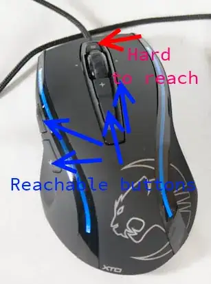

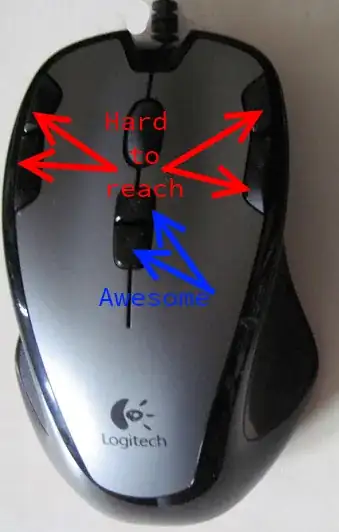

I've bought two great mice since asking this question (for different systems) and had a few things that I realised with them.
Firstly of course, that the position of the buttons was crucial - I had a Logitech G300 which was a great mouse, but 4 of the mouse buttons were awkwardly positioned.
On the other hand, the mouse I got after that, for my new system was a little more accessible
This will naturally depend on your grip style, hand size, but button positioning is essential in picking the perfect mouse.
I found that I preferred different resolutions for different tasks, and that the ideal mouse resolution setting depends on screen size. The G300 goes up to 3200 dpi/cpi, and this is what I use on it by default, on a Full HD screen (1920x1080). My Kone XTD goes up to 8200 DPI (and I only have a 1600x900 screen on that system) - I use the full resolution for normal use, and turn it down to 3200 dpi for normal use. You can, however also leave the mouse at full resolution and turn down the sensitivity either in windows or from the mouse configuration program. While a lot of gamers do this, this means you can't use the built in resolution switching option from the mouse configuration software effectively. If you're happy with your current mouse, and there isn't another compelling feature, there's not as much point in paying more specifically for higher resolution.
Mouse configuration software seems to be a useful thing too - I have my mice set to use the keys under the scrollwheel for scrolling, and once you breach the 3 button paradigm, you really want to be able to re-map these extra keys. You might be able to use them, in many cases as extra keys in games without remapping however, which might be simpler in many cases.
