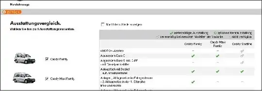

I'm trying to save (as in: for printing / putting it in a PDF -- I'm not interested in the HTML, but in the rendering of the html to be able to print the table or at least view it offline) a table view from this car site:
http://cc.volkswagen.at/nwapp/nws/ICC3/LNF!de!!!L!!!/?MGN=220&AUVN=&rel=statBanner_Konfigurator&rel=statCc_Caddy
It's german, but it's not very difficult to navigate, just click on the Vergleichen Sie die Ausstattungen link, and it will display a (very long) table:
I simply have not managed to save this table either via printing the website or saving it. (Tried with IE8 and FF7.) I also tried selecting the table text and doing copy&paste into MS Word -- no luck either.
I also tried the tool DuckCapture, that says it should be able to "Capture a Tall Website" but the tool is unable to scroll the table on this page. (I assume because the table and it's scrollbar are dynamically generated from javascript ...)
How can I save the table as it appears on screen (the whole, scrolled, table)??

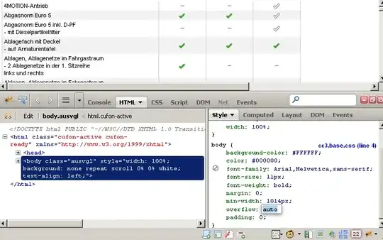

You can do it using combination of some Firefox add-ons:
Aardvark & Firebug are enough if you have physical printer.
Steps:
  1. Install Firefox, current version is 7.
  2. Open about:config page, and add boolean setting extensions.checkCompatibility.7.0 = false.
  3. Install the extensions, restart Firefox.
  4. Load page and do whatever you want to make it look like you want it printed.
  5. Start Aardvark (you should have right-click context menu entry to do so). Click anywhere in the table and then keep pressing w (wider) until you have situation like on screenshot (you have Aardvark help on h. Narrower is n, quit Aardvark = q). Then click i (isolate).
    Aardvark
  6. Open Firebug (yoy should have button in bottom right or top right of the browser). Select <body> node and change overflow from hidden to auto.
    Firebug
  7. Open print preview > page setup > options and tick "print background colors and images".
