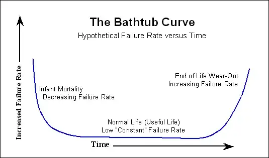

Many electronic devices follow the "bathtub curve",
where there are many failures early on, then a long time with hardly any failures, and near the end of life the number of failures rises again. In hard disks there are also some mechanical parts which have a more linear failure curve; this slowly ramps up from day 1.
If the manufacturer says for instance 1000 000 hours MTTF (that's most often POH, or Power-On Hours) it means that on average the drive should last > 100 years. Some drives will last longer, some will fail earlier on. So despite the 1000 000 hours it's perfectly possible to have a failure after 1000 hours. I once had a drive failing within a week, and then you have to think back of the bathtub curve. The replacement drive has been spinning happily for >50k hours.

    A few things worth noting might be the fact that early failures are often called burn-in. Manufacturers that have much lower early failures often run devices through their burn-in phase. Also that pure electronics do not exhibit a wear out period and only a burn in. – Kortuk Oct 25 '11 at 10:26
    Note that when you are calculating the MTTF (or MTBF), you're usually using just a single distribution to model the failures. Therefore the calculation is either based on "infant mortility", "normal life", or "end of life wear-out" distribution. The only thing which distinguishes these three distributions is the Weibull shape parameter, if you're using Weibull as your basic distribution. The only case in which the failures would come out of the "normal life" distribution is when time would have no effect on the failure rate, and therefore the distribution would be exponential. –  Oct 25 '11 at 13:49

Usually, after the burn-in process, the start of the bathtub curve that has already been mentioned is no longer seen by the customer. We are lucky, and only see an increase in failure likelihood over time.
So if you look at the MTTF that is quoted by the manufacturer, for any failure modeling you might want to do, you can disregard the start of the bathtub curve.
