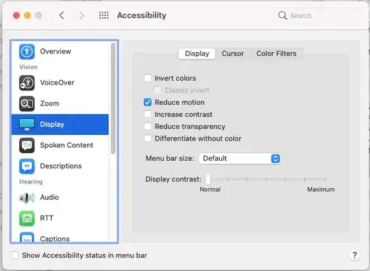

There is an option in MacOS that speeds up the animation somewhat although still not instant: On your Mac, choose Apple menu > System Preferences, click Accessibility, then click Display > check "Reduce Motion".
Chris Smith
  • 189
    Browsers can tap into this setting now and developers might disable animations on websites with this enabled, I wouldn't advise using it anymore if you just want faster spaces transitions – David Fregoli Dec 09 '21 at 10:01
    Unfortunately, it does not speed up the transition — it just changes it opacity fade instead of slide. You can't interact with a new Space while animation is in progress :( – Pavel Alexeev Dec 16 '21 at 13:20
