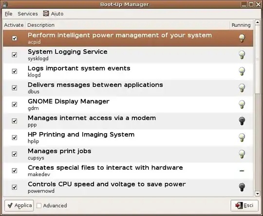

You can use Boot-Up Manager for start and stop boot-up scripts, without the necessity to handle thru complex links and permissions.
apt-get install bum
