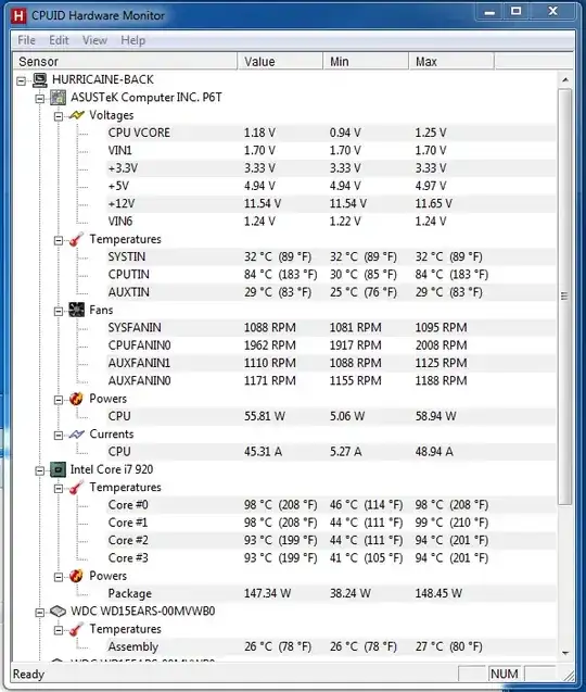

I've run IntelBurnTest to max out the cpu to see if it was a heat issue and at full tilt after 20 min it was only at 85C and the machine didn't crash. I also took a look at the voltages during this test, with a screenshot at the bottom of this post

Running full tilt voltages Running full Tilt
Idling Voltages
Idling Voltages
