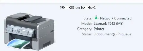

For network printer management on client computers we use printUI.exe (a wrapper for rundll32 printui.dll,PrintUIEntry). This command must be executed from an elevated command prompt.
Given there is a printer called PR-XX-03 on FS-ZZ-TU-1: PR-XX03 on FS-ZZ-TU-1
To remove the printer, use this command /dn (/dn = Delete Network Printer):
 printui.exe /dn /n "\\fs-zz-tu-1\pr-xx-03"
Note: You have to use the \servername\queuename format, the name displayed within Devices and Printers is “beautified” for the user.
To remove the drivers for it afterwards, you need to stop the printer spooler first because the printer DLLs are loaded within the spooler process so they can’t be removed directly:
net stop spooler
net start spooler
After that, you can remove the drivers by specifying the model of the printer (/dd = Delete Driver)
printui.exe /dd /m "Lexmark T642 (MS)"
For any printui.exe command you can also specify the option /q which will hide any error message (e.g. printui.exe /dn /n "\fs-zz-tu-1\pr-xx-03" /q). This can be useful when you want to automate these tasks.
