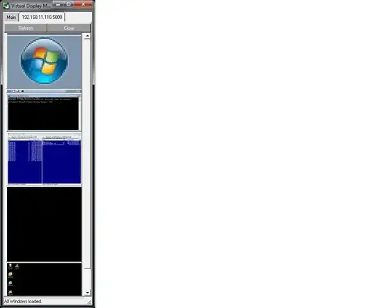

The solution is named VDM (Virtual Display Manager). It works as a set of two programs:
  • The Server program:
Server
  • The Client program:
Client
It works perfect, but it has a possible security flaw, depending on your desired behavior: it allows access to every window (the server side can not restrict):
Access to every window
