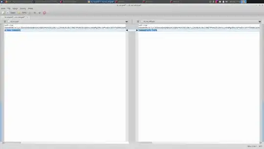

Private key will change in this manner. Not due to it's comment, but rather due to change in it's format. See the comparison here on a key created just for that comparison.
private key comparison - format has changed
Note that for pub-key I've effectively broken it so Meld shows better what changed: spaces have been changed with line breaks (this breaks the format).
(broken) public key comparison, only comment has changed
