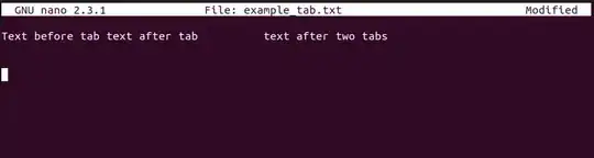

To put tab:
  • First press Ctr + v and
  • Then press tab key.
Example
Using above mentioned step adding tab enter image description here
Saving in file enter image description here
Final Output enter image description here
Reference: https://linuxjourney.com/lesson/cut-command
