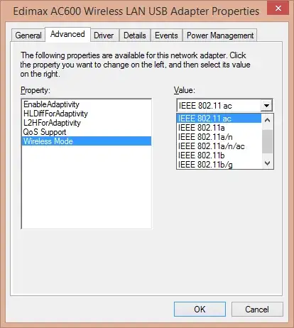

Mike
Depending on your network card, you may be able to configure it in the driver. For example, in Windows 8:
GWLlosa
  • 576
  • This is good for people like us who have ac but not for those who still use n for both 2.4 and 5Ghz of course. Isn't there also a way to disable wireless n to pretty much achieve the same results? – mchid Oct 15 '15 at 23:37
