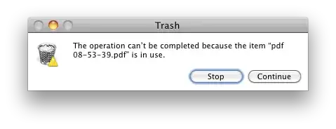

When you try to empty the Trash in OS X, and there is a file still open in an application, you receive the dialog:
The operation can't be completed because the item "…" is in use.
How can I find out which application or which process still uses this file?

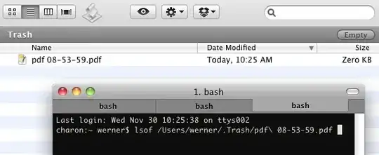

Using lsof to find what's keeping the file open
Open up Terminal.app and use the following command to get to your Trash:
cd ~/.Trash
Now, enter the following command:
lsof name-of-file
For example, in the above screenshot, it would be: lsof pdf\ 08-53-59.pdf (important to escape spaces here). You can also just enter lsof with a space afterwards, and then drag the file from Finder's Trash into the Terminal window.
The command will output something like the following:
charon:.Trash werner$ lsof pdf\ 08-53-39.pdf
COMMAND  PID   USER   FD   TYPE DEVICE  SIZE/OFF     NODE NAME
Finder  5022 werner  txt    REG   14,2 636141715 32494023 pdf 08-53-39.pdf
In that case, we know that Finder is keeping the file open. For any other application, it would be easy to just activate and quit it. In case of the Finder, there's no obvious "quit" button.
To kill the Finder and release the document, just enter the following in the Terminal:
killall Finder
You should now be able to empty your Trash.
