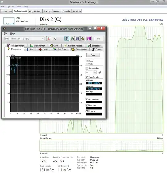

I installed Windows 8 preview on a VHD image and it seemed to work until I actually started using it. I´m seeing terrible performance. Installing anything makes everything else "stutter" or freeze for up to a couple of seconds at a time.
I looked up hard disk performance in the task manager and this is what I found:
It doesn't seem right it has 2500ms response time while reading/writing at those speeds. Is this an issue with my drive, installation or VHDs in general?

I've been running Windows 8 from a VHD from the first day and had no problems.
The only thing the VHD install seems incapable of is that you can't utilize Hybrid Boot...
As for your problem, I don't experience it. Please note though that I'm using a SSD...
Some suggestions:
  1. Be sure to install all your drivers on Windows 8 DP! Use compatibility mode where necessary...
  2. It seems like you have a lot of disks connected to your system, please note that a broken cable / controller or hard disk can cause other I/O to be at 100%. Try disconnecting everything that's not necessary to boot your system and then try again to see whether it improves the behavior...
    Or, you might want to reboot in your previous OS and compare it with Windows 8 Developer Preview.

  • You are still getting response times at 500ms. To me it just seems as if you have the same issues but the SSD just makes them less visible. – richardwiden Dec 04 '11 at 13:46
  • @Richard: Isn't that expected behavior when running a benchmark? The disk queue is filled so the response time for a single queue entry is delayed. If I just browse the disk and do some normal stuff it stays within the 0 - 100 ms range. The thing to note is that I don't experience any sluggish performance. In your case the **speeds suffer under it** which I don't see when doing this benchmark. The active time is also different, being around 90% is way different than being at a constant 100%... – Tamara Wijsman Dec 04 '11 at 13:48
