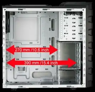

For a case look for ones with a removable drive cage as that provides extra room for longer cards. An example would be the Cooler Master HAF912 (I have this case so know there is lots of room with the extra drive cage removed). Specs say 15.4". If you look at the picture the cage the longer arrow goes over is removable.
