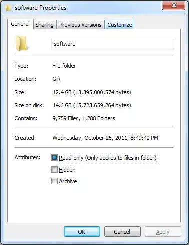

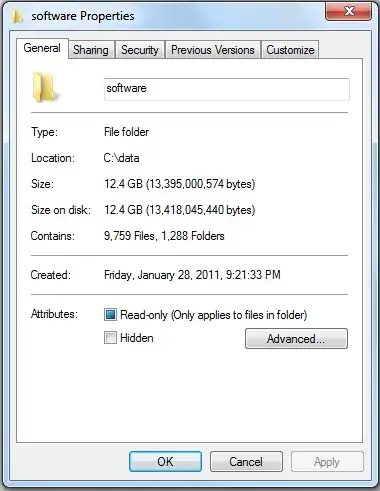

I recently bought a 750 GB 2.5" hard drive and put it in an external enclosure. It has Advanced Format Technology (AFT), but I use Windows 7, so I assumed I would be safe.
  1. I decided to try exFAT, because I was enticed by the reduced overhead
  2. For "Allocation unit size" I selected "Default allocation size"
  3. Tried with "Quick Format" un-selected first, but it was taking too long, so I stopped and started over with "Quick Format" selected
  4. After drive was formatted, looking at the format options again shows that the "Allocation unit size" is 256 KB
The drive works fine, but I had a question about the difference between "Size" and "Size on disk."
On my 120 GB NTFS formatted internal hard drive, the difference is only 0.16%. However, on my much larger, exFAT formatted external drive, the difference is 17.38%. At that rate, the most I will fit on this 750 GB drive is 637 GB (with 0 free space).
What format options should I use to maximize usable disk space?
What impact will my current settings have on performance? What impact will your recommended settings have on performance?

Internal hard drive
Internal hard drive
External hard drive (with big space difference!)
External hard drive

The default allocation unit (cluster) size in exFAT is much larger than the default allocation unit size in NTFS. As you've noted in your question, exFAT defaults to 256KB, but NTFS defaults to 4KB for volumes larger than 2 GB.
Because allocation of storage must occur in whole clusters, a file that is not a multiple of the cluster size will result in wasted space on the storage device. This wasted space depends on the size and is generally larger when the cluster size is larger and when there are many files on the device. This condition is called internal fragmentation, and the wasted space is called slack space.
For example, a 257KB file will require two allocation units to store on your exFAT volume, taking up 512 KB of space. The same file would require only 260KB on an NTFS volume with 4KB clusters.
