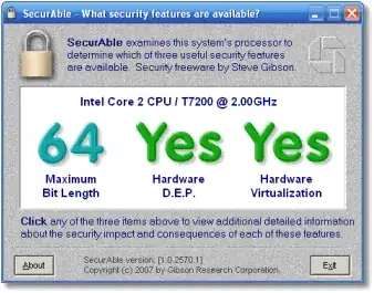

According to your motherbaord's manual, that entry should be there, unless you have a CPU that doesn't support VT. Have you tried updating your BIOS to the latest, and then resetting it to factory defaults?
Also, perhaps check out Securable by Gibson Research to find out if your hardware supports virtualization.
enter image description hereenter image description here
