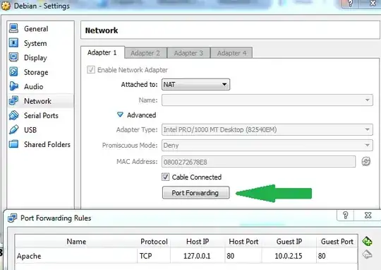

With bridged network mode I lost internet connectivity in my guest.
Instead I used NAT mode with port forwarding.
This is an example where Apache hosts websites in the guest:
