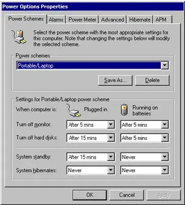

Sometimes in windows when you plug the power in, it changes the battery/perfomance mode to MINIMAL PORTABLE/LAPTOP, check that it does not do that.
In Control Panel double click Power Options. Here you can set timeouts for your monitor, system standby, and hibernate. Notebook computer users can specify an alternative power scheme that will take effect when the PC is running on battery power.
Another problem can be the system driver, make sure you have the original HP driver installed.. Usually the mouse pad from HP use the Synaptics Drivers, and that should reflect in the device manager.
If the problem persists it is most likely going to be hardware related, by the sounds of things this is an old notebook, and could just have some fault components.. Sorry.
