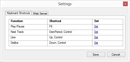

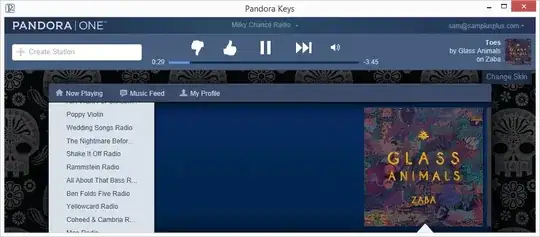

This is a little older, but I have some to offer a solution for those who do not want to write code. I wrote an application that lets you map your keys to Pandora. Check it out I call it Pandora Keys the application itself is open source so you can edit it if needed. It has some other neat features which are outlined on the website.
Disclaimer: I am the author of this application.
  • This works well for me, thank you. Just an FYI for others: This does use Internet Explorer. – Heptite Sep 29 '15 at 17:10
  • Another note: It lets you skip ads! Just press the `>>` button on your keyboard. – Heptite Nov 04 '15 at 00:55
  • @Heptite Author here. Thanks for the comment, it does support media keys, or you can also define your own shortcut keys. I should mention the source code is also available at https://github.com/SamPlusPlus/Pandora-Keys since the accepted answer does talk about writing your own script. – Sam Plus Plus Nov 04 '15 at 16:35
  • Forgive me, but I'm confused. I'm aware it does support media keys; that's why I installed it. – Heptite Nov 04 '15 at 18:47
  • @Heptite sorry I didn't mean to confuse you. I was just trying to make the distinction that it can support media keys like actual play or pause buttons, but you could also set your own keyboard shortcuts like saying Ctrl + N skips. I was only trying to make the point that the keyboard shortcuts are flexible. Anyways I am glad you are enjoying the software. Feel free to let me know if I can make improvements. – Sam Plus Plus Nov 04 '15 at 20:49
