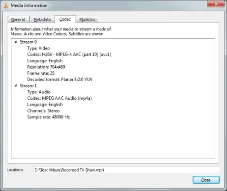

Once converted, VLC will give the following details about "Recorded TV Show.mp4":
The file I converted is now 530MB (down from 1.59GB) for 1 hour and 50 minutes of SD content. This means it is approximately 1/3rd of the size of the original WTV file.
