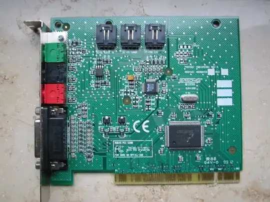

I have this old but still working fine audio card: Creative AudioPCI 9918.
This is not my image, but this is same PCB
I was using this card to record my system sound on the old computer, but now it's just lying around. So my idea is to use this card for recording sound and use my front panel for mic and headphone. Will this setup work or I just need to think of something else without loosing front panel?
