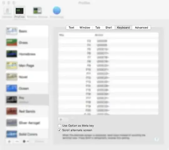

  • @AlexCoplan It's the equivalent setting to *Use option as Meta key* in [Terminal](http://i.stack.imgur.com/oTbkU.png). You need to remap the character to a different key, or change your Terminal's configuration. – Daniel Beck Dec 30 '11 at 14:59

In Terminal preferences, go to Profiles then Keyboard. Disable the Use Option as Meta Key option.
