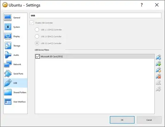

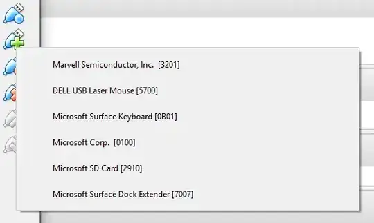

As kobaltz mentioned. To support the USB 2.0 and 3.0 versions you need to install the Virtual Extension Pack, I installed the 5.2.22 Oracle VM VirtualBox Extension Pack, and you can download it from the Virtual Box download page. Once you download the file, you can directly go ahead and install it, the same will be added to your Virtual Box extensions.
You should also add your SD card to the device filters in our Virtual Box, please go to Settings – > USB -> Click on the Add SD card Attached option.
Now you will be able to your SD card in the Filters.
Go to the Files and see the see the SD card folders (I use Ubuntu Linux Distribution)

For me the solution was to turn-on USB device with SD card, using
Devices -> USB devices ->My card reader,
and after few seconds new disks appear in my VM.
I have installed VirtualBox Extensions Pack before that.
