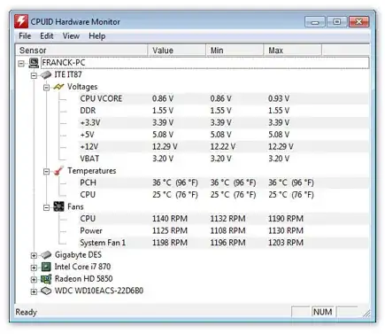

UPDATE
This is my HW Monitor Screenshot:
UPDATE 2
What I've learned from the answers. This problem is not solvable by people like me. I'm not kinda electrician man, and I have no multimeters/testers. It's too much for me to buy one just for this private task. (Though, I have to, maybe, to be able to solve such tasks in future). Without hardware, I can control voltage only, that can prove the suspicion but not refute. To make the things worse, software like HW Monitor is buggy, since it shows VIN1 values instead of +3.3V like in my case.

The information reported by various sensors on modern CPUs, motherboards and graphics cards can be viewed with programs like CPUID's HWMonitor.
Brian
  • 8,896
  • 37
  • Hm... I see that in 3.3V row I have only 1.89V/1.87V/1.89V values. What does it mean? "A sagging output voltage is a common sign of an underdimensioned power supply" as MSalters wrote, so the system is dying of malnutrition? – noober Jan 02 '12 at 17:03
  • Please look at my screenshot. I have no 12V row at all and 5V row seems invalid. – noober Jan 02 '12 at 17:08
  • The 5v does seem off. For the 12v make sure the 4 pin ATX +12 volt power cable is connected to the motherboard. It's the square connector below and to the left of the CPU for your [ECS H67H2-M3](http://www.ecs.com.tw/ECSWebSite/images/Products/large/H67H2-M3_580_02.jpg) motherboard. – Brian Jan 02 '12 at 18:35
