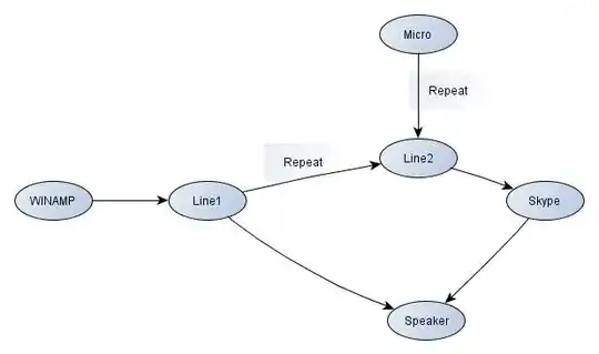

I'm using this solution from a long time ago, though is even more difficult, but you don't need to have two skypes running at once.
Create two lines with VirtualAudioCable.
Configure the playing program to output to Line1.
Using VAC repeater copy Line1 to speaker.
With other instance of VAC repeater copy Line1 to Line2.
With other instance of VAC repeater copy your Mic to Line2.
Configure Skype to input from Line2 and Output to Speaker.
diagram
If you don't need to listen to the music, and just let the other person to listen to it, you just need one line, as Darwin said. And set Skype input as line1. If you want the other person to listen to you and to the music just use VAC repeater to copy microphone to line1.
