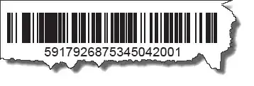

This is a barcode off an order form. We have 100's of these to process, and several off the shelf mobile solutions scan it properly, while others fail.
Knowing the barcode type will allow me to narrow my search of capable barcode scanners.
Barcode Type in Question
Adding a second barcode image, with no border to see if that makes a difference.

  • i'm wondering if the border around that image, is affecting the scan? I'll add a new image, with no border. – ScottCate Jan 10 '12 at 19:14

This appears to be in Code 128 format.
Extra info - although it looks like Code 128 it is poorly printed. Look at the very wide black bars. They are incorrect as there should be a one or two white spaces in there. For Code 128, the widest bar should only be 4x the narrowest bar. So looks like a printing error and you will never read.

  • I was thinking Code 128 format also. Were you able to scan it? I tried scanning it on Psion Teklogix Workabout pro and it wouldn't scan. – Shane Wealti Jan 10 '12 at 16:39
  • My wife has these types of barcodes at her work (see works as an evidence tech, and I work in IT, so I get questions from her). She has the same problem with her handheld scanners not reading them... even though they appear to be Code 128 compliant. I suspect that it could be a quiet zone violation, but have not been able to confirm this. You have to have whitespace of at least 10 widths of the narrowest line to both the left and the right of the barcode. Could that be the case for you? – newmanth Jan 10 '12 at 16:55
  • Just a note: My android phone couldn't scan it either. If you happen to find a list of which types are supported, you can narrow it down? I can't seem to find any such list though. – Simon Verbeke Jan 10 '12 at 17:00
