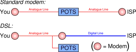

Dial up connections use the voice circuit for data transfer so the bandwidth is limited to bandwidth of voice channel, whereas DSL uses a separate frequency range for data which is much broader than voice bandwidth (hence the term Broadband). DSL uses a splitter to separate the voice and data frequencies and therefore both can work simultaneously.

daya
  • 2,571
    Also: a digital signal vs an analog signal. But mainly it's the frequency range. – Joel Coehoorn Jan 11 '12 at 17:15
    @JoelCoehoorn: in both cases, it's a digital signal carried by an analog signal (hence the use of a [modem](http://en.wikipedia.org/wiki/Modem)). – Bruno Jan 11 '12 at 17:20
    But I was always curious why can't conventional modems use all the frequencies DSL modems use to provide the same (or even higher) speeds while using a line exclusively (with no phones). – Ivan Jan 11 '12 at 20:29
    The limitation is not with modems,It is a limitation of the legacy telephone circuits which filter the signals and only allow frequencies 300-3400Hz(human speech frequencies) to pass through. Since anything outside this range will be filtered at various points in the system. Only this narrow range can be used for communication with telephone dialup . – daya Jan 11 '12 at 20:38
    This diagram is largely wrong anyway: The reason 56k works (and the reason it has faster download than upload speed) is that the ISP end does *not* have an analog modem. It skips a modulation/demodulation step and drives the head end directly. Because the download direction is generated digitally at the ISP it avoids some filtering which lets the download speed get closer to the theoretical max (well described in another answer). – Ben Jackson Jan 11 '12 at 23:31
    It may help to mention the definition of "POTS" (Plain old telephone service?) – Steven Lu Jan 11 '12 at 23:58
  • @daya where does the filtering happen and how does DSL 'bypass' this? – greatwolf Jan 12 '12 at 04:58
    @VictorT. : The filtering happens at the line card in the phone switch. The ADSL head-end is installed in your neighborhood (hence the distance limits quoted for ADSL) – MSalters Jan 12 '12 at 08:39
  • -1 Actually 56k/V.90 requires that there is only only A to D conversion and that the voice circuit is digital all the way to the ISP, so your diagram is incorrect. Your text is more or less correct. – teambob Jan 13 '12 at 00:10
