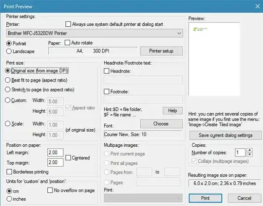

The best tool I found to do this was IrfanView. It is originally just a picture viewer but has evolved into a very powerful multi-tool and works on Windows 7 and 10. See the following picture from the print dialog for all the options.
Irfanview Print dialog
