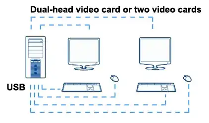

There's a software for that, ASTER IBIK, 1 cpu and multiple monitor with mice and keyboard fully working. enter image description here
