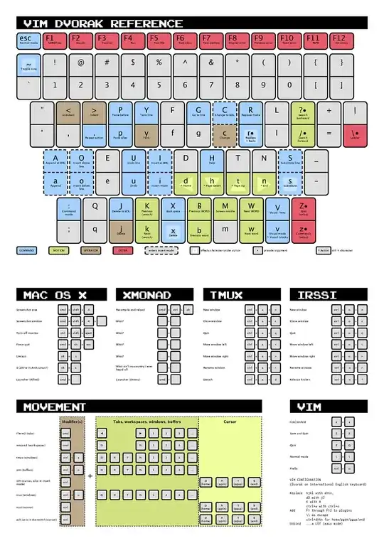

I drew a picture (the colours are horrible, I know) to illustrate what I had in mind. I use Dvorak and replaced vim hjkl movement with dhtn - I'll write left/down/up/right to have it make sense for those who don't use vim. Let's keep it to iTerm2 rather than the entire OS X desktop environment (as well as Gnome and KDE). Basically it comes down to this:
cmd+left/right/number for workspaces in Xmonad (or whatever window manager you like)
alt+left/right/number for windows in tmux
ctrl+alt+left/down/up/right/number for buffers in vim
ctrl+alt+left/right/number for windows in irssi
ctrl+left/down/up/right for home/pg down/pg up/end in vim, irssi and zsh
enter image description here In OS X ctrl+left/down/up/right already works like the above, and alt+left/right moves the cursor by word as opposed to just left/right which moves it by character.
Wouldn't this be fairly logical and intuitive? Am I missing something (conflicting keybindings) or is this doable?

I tried putting together a cheat sheet or reference card. After exploring various possibilities I ended up doing the following:
  1. Switch from a Swedish keyboard to an English (international) due to the latter being (in my opinion) superior when writing code as well as still being able to type åäö by alt+a/+w/+u+a/+o.
  2. Switch from QWERTY to Dvorak because I like how the keys are positioned (no scientific claims here) for programming purposes (had a look at "Programmer Dvorak" but that was too much).
  3. Replace vim hjkl movement with dhtn, dD with jJ (mnemonic: "junk"), K with H and the ctrl+w prefix with ctrl+o.
  4. Some minor additions (and unbinding advanced features to start out easy)...
TL;DR - stick to using prefixes where available, e.g. ctrl+a in tmux, ctrl+o (Dvorak)/ctrl+s (QWERTY) in vim and irssi. This seems to have the least consequences and be somewhat cross-platform-friendly.
vim dvorak reference card
