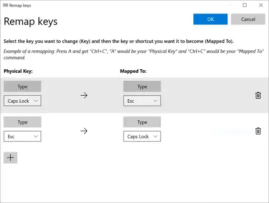

PowerToys switch esc and caps lock solution for Windows 10/11 (no conditional)
This answer covers only the switch esc and caps lock without considering other keys being pressed or not:
Selling points:
