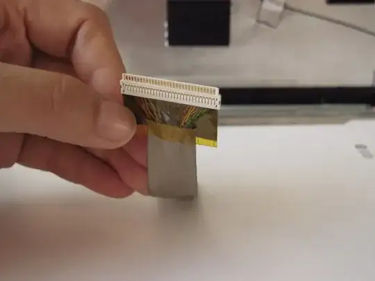

Look at this picture, and the connector on it. It is pretty common connector on newer model notebooks... after Celeron ones. Any really older notebooks have varying, and propriety connectors that will not be compatible.
I think these are called PPI but many distributors call them 40PIN Data Connectors. I never actually thought about what it is called, i guess I must have a photographic memory.
That type of connector works with any size LCD, so you can use a 13" in 15.6"- obviosly it wont fit in the frame it was built for.. but the picture will work fine, because it uses the same protocol and image processor on the LCD chip.. So it can handle the scaling, refresh rates and all that mumbo jumbo directly on the LCD, making it an easy standard to work with.

I seem to think the same connector is also referred to as LVDS – Journeyman Geek Jan 23 '12 at 14:15
Hi, by looking at the picture LVDS is the one with pins, and is common in Macintosh Screens and older PC/Notebooks.. and are not cross compatible/ but it might be the Parallel Version of LVDS... but i cannot find any data relating to it really.. – Piotr Kula Jan 23 '12 at 14:25
LVDS is just the electrical interface's name. It's not the actual connector which yes, is some proprietary NIH stuff prior to the 40-pin ones. ;) – Aug 12 '13 at 10:20

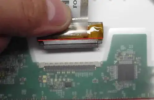

Look at this pic (stolen from ppumkin):
Now, look at this other one (same pic):
The interface used to connect laptop displays is called LVDS. The one in the picture is one of the most common connectors for LVDS (the other one is 30-pin, looks the same but different size).
Now, unless you can find an exact part number or model code for the screen, you should consider it as incompatible. Yes, they may use the same connector, but there are no guarantees whatsoever that they're using the same pinouts.
Manufacturers usually use different pins for each model even though they're the same connector.
Heck, even the same screens may use different pinouts! (hence why the same two pictures above). I could not reall the specific one, but it did happen. There are no guarantees that the pictures above use the same pins.
Compatible screens are pretty rare, so the safest bet is to get the exact, same screen. An even safer bet is to get the exact same laptop, and do a screen transplant.
