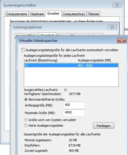

After I changed the pagefiles size to 400 / 4000, see: 3

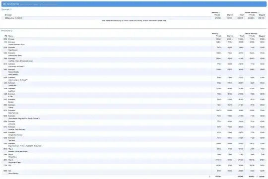

It still doesn't work and browser and laptop crash. Now I ran memtest86+ (v.4.20) and Windiag and exported all the browser extensions and their memory footprint through about:memory. 5

Generally your system is not going to have a huge problem with a small pagefile. It popping up is not normal. If you could run a full offline defrag, and reset the pagefile , and lock size so it doesnt fragment, it could be "better" but it does not require being 6-9G in most situations. The settings you show are not locked (400-4000), it isnt the best way to set, althought it would work. a balance between your settings and windows would be 1000 1000 locked.

  • Thanks for the hint, I knew the settings might not be best. I will set it on 1000/1000. As said I don't have any images mounted and never leave them mounted longer than necessary. Paymo Plus is a timetracking software (see Google ;)) paymo.biz/paymoplus. Do you notice something about Paymo? It starts up first thing on my laptop but it usually runs OK and I didn't notice it in the ProcessExplorer. Fancycache was removed from me now! – grunwald2.0 Jan 26 '12 at 02:54
