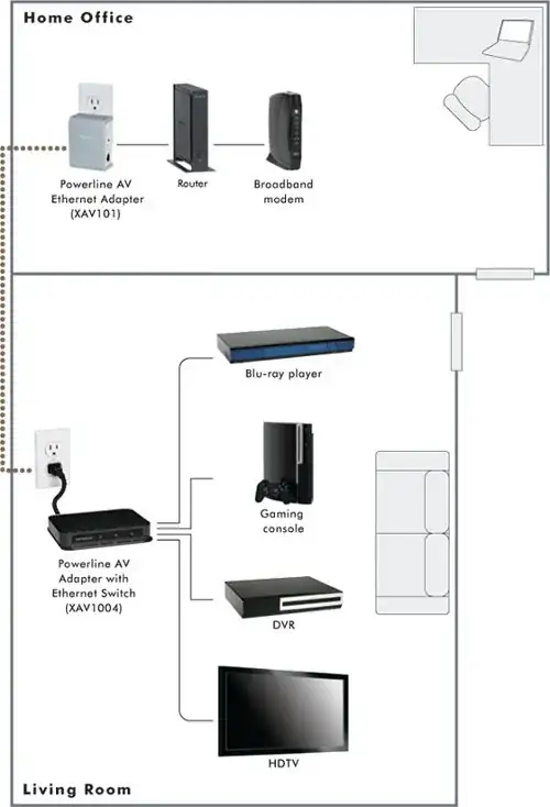

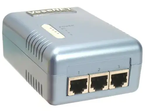

I would use powerline networking to link to a switch at the far end.
You can buy a pair of HomePlug units that plug into ordinary wall electric sockets. They will bridge the two ends of the room together without any cables lying on the floor.
Diagram of Homeplug network A combined homeplug adapater & ethernet switch

    I second this idea, Powerline is a lot faster in general than wifi and doesn't suffer from so many problems as wifi can, especially if your going to be streaming video over the connection. – Iain Simpson Jan 27 '12 at 09:27
  • -1 For all the difficulties I have seen using powerline networking in general. – Joshua Drake Jan 27 '12 at 16:13
  • I am hesitant about this idea. But, let me ask this. I know from experience, that one side of the room is on one circuit and the other side on a separate circuit. Does this work across separate electrical circuits? – Steve Jan 27 '12 at 16:57
  • @Steve: According to the [FAQ](https://www.homeplug.org/about/faqs/) that should be OK even if they are on different phases. Normally all the circuits in one room are wired to a common fusebox (AKA consumer unit) or point of supply into the building. – RedGrittyBrick Jan 27 '12 at 17:17
  • @Steve: See also http://superuser.com/q/348692/52492 and http://www.jdhunt.com/homeplug/aug07/PLC_Cross-phase_Coupling.pdf – RedGrittyBrick Jan 27 '12 at 17:26
  • @RedGrittyBrick Thanks for the info. I just found this article **"Install Powerline Network Adapters without Neighbor Interference"** [link](http://www.popularmechanics.com/technology/how-to/4213418) The article mentions some points about security. My business relies upon these 10+/- computers having a reliable network connection and strong security. – Steve Jan 27 '12 at 17:53
  • Powerline networking seems overkill for this... – user606723 Jan 27 '12 at 20:29
  • This DOES sound like a BIG security risk! After all, it IS publicly accessible infrastructure. – Arlen Beiler Jan 27 '12 at 20:45
    Powerline is a poor choice. There's a reason it hasn't been adopted widely. – Chef Flambe Jan 27 '12 at 21:50
  • @Steve: as that link says "all powerline networking gear either requires pairing via physical buttons on each device, or includes an optional encryption scheme, similar to that used with Wi-Fi, that will prevent anyone from jumping on your network -- even if you're on the same circuit." A typical product spec says "128-bit AES Link Encryption with key management for secure powerline communications" – RedGrittyBrick Jan 27 '12 at 22:26
  • Yes, and that's what I understood from the article. Call me paranoid, but I am just not comfortable with this option. As @ChefFlambe pointed out, it is not widely adopted. I feel WiFi has had a lot more experience. Either way, this option seems like I am handing my CAT5 cable to my neighbors here in the building. Just saying. – Steve Jan 30 '12 at 19:54

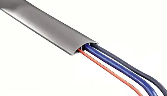

You could leave the cables running along the floor and use a cable protector to protect them and prevent tripping.
cable protector

  • mixed feelings on this. Depending on the location & flooring you can end up with the carpet being protected from the sun and a line being left when you remove it. – Sirex Jan 27 '12 at 14:35
  • If there is carpet, even better. Pull it back, cables go under. – Rob Jan 27 '12 at 16:17
  • Yes, its a carpeted rented flat. I would lose my security deposit if I pulled up the carpeting, even just a little. And these 'Cable Protection' do not keep people from tripping, they only protect cables. – Steve Jan 27 '12 at 16:32
