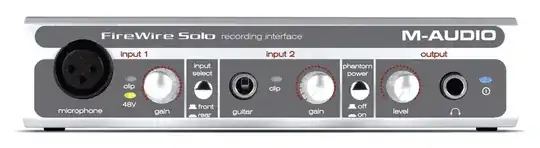

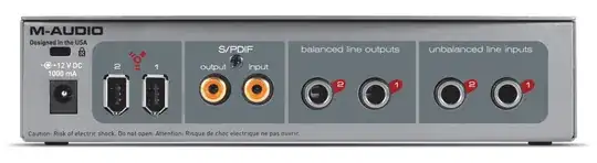

I was going to suggest to the M-Audio Transit. But, I also recommend the M-Audio Firewire Solo recording interface. It has rca spdif in and out. It is like $200 bucks new and you can find used ones for 100-150. I own one and it works great.
http://maudio.net/products/en_us/FireWireSolo.html
solo back
solo front
