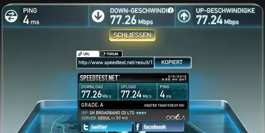

Attached you find a most recent speedtest.net result: speedtest.net result.
What is going on there?

    77Mb/s?? I'd kill people for that kind of bandwidth at my home. – surfasb Feb 03 '12 at 12:13
  • As we all know we have to divide by eight, so we get a nice pure 9,655 MB/s Down- and Upload speed. But (at least according to jDownloader) I already managed to achieve over 10 MB/s via several OCH connections, as obviously the maximum capacity here is more in the ninety's (90 Mb/s)... – grunwald2.0 Feb 03 '12 at 16:02
