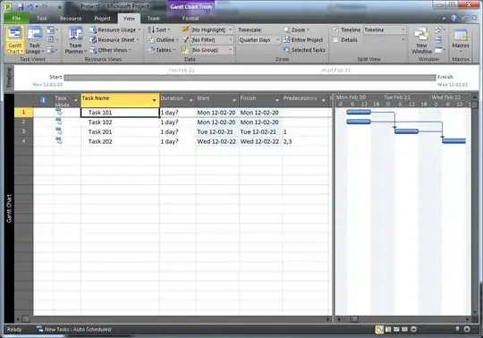

Task 101, 1 day, starts 2/20/12
Task 102, 1 day, starts 2/20/12
Task 201, 1 day, predecessor 101 FS
Task 202, 1 day, predecessor 102 FS, 201 FS
Initial state

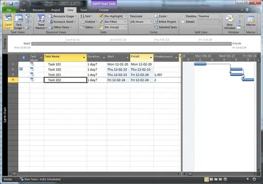

This arrangement works fine (Task 201 is completed on 2/21 and Task 202 is completed on 2/22) but if for some reason the predecessor Task 102 is bumped up to, say, 2/23/12 then Task 202 will be moved up as well, but 201 will stay put leaving a gap in between them. In this case, I could try rewriting the dependencies:
Task 102, 1 day, starts 2/23/12
Task 201, 1 day, predecessor 101 FS, 202 SF
Adjusted project schedule
Now Task 201 is completed over the day of 2/23, and Task 202 is completed on 2/24. However, if the predecessor task dates changed again, so that both are completed by the end of 2/20, then Task 202 will shift and actually start at the same time as Task 201 (since a start-to-finish relationship does not require that one task starts the same time another task finishes, but just that the dependent task cannot be completed until the primary task begins).
