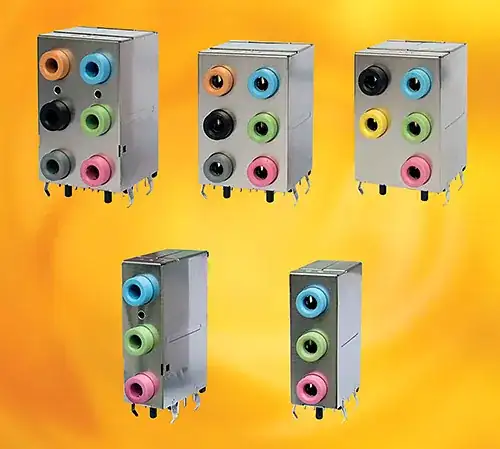

2.0 will have 3 jacks - Green, Blue, Pink
5.1 will have 5 jacks - Green, Black, Orange/Yellow, Blue, Pink
7.1 will have 6 jacks - Green, Black, Grey, Orange/Yellow, Blue, Pink
In the pic below, clockwise from top left: 7.1, 7.1, 5.1, 2.0, 2.0
