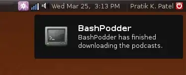

I was wondering if there was a way to display a notification or something from the command line at a certain time. Like when the clock strikes 4:00pm. It would be nice if it would display it using Ubuntu's notify-osd tool:
