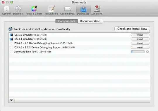

My suggestions:
  1. Install the xcode commandline tools package via Xcode -> Preferences -> Downloads-> Components: xcode
  2. Install homebrew (upgrade your path in .profile, .SHELLrc or whatever to include /usr/local/bin before the system default like /usr/bin).
