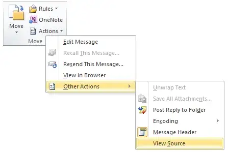

Open the email on the Message Ribbon and go to Move > Actions > Other Actions > View Source
screenshot
It invokes Notepad and shows the full html source.

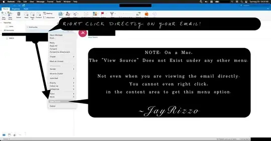

The easiest & ONLY way for me on my #Mac using #Outlook.
Right Click on the Email Directly in the middle column.
This is the only location I found it, there is no option menu to add or select from. I am also unable to customize the ribbon.
I hope this helps.
