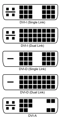

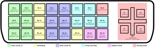

No, The analog signal is carried over extra wires that is present in a DVI-I cable that is not in a DVI-D Cable.
Click the image below for a larger view. Color coded representation of a DVI connector
Here is another image comparing the different types of connections with the different pin-outs. Comparison of pinouts
Both images taken from the Wikipedia page on DVI
