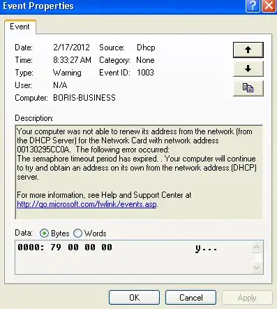

This constantly started to happen some time ago. I connect to my router andand lose every few seconds connection to router and it reconnects again. I have screenshooted most errors that Event Viewer reported. First comes overview:

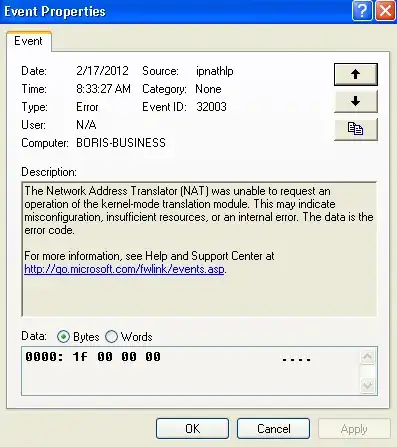

And now 3 events that happened at the same time:
As you noticed, all 3 came at same time, when first was warning saying something about semaphore timeout, second was about losing lease and last was about NAT.
After several minutes of this happening, i could not connect to router as NIC showed that it was aquiring address and just repeated connection attempts until i just had to cancel connection. You can see this in Event Viewer:
This problem happens with other hotspots as well.

This could be caused by a few things, but looks to be specific to your NIC.
Try these steps:
  • Upgrade the NIC drivers
  • Try and get alternate drivers working (uninstall custom drivers and see what windows comes up with via windows update, or install vendor specific drivers)
  • Boot to Ubuntu via a live CD, and see if you experience the issues under a different OS.
  • See if any high network traffic applications are consistently running when this happens.
  • Wireless Zero Configuration might be interfering, disable the service.
  • Disable any 3rd party firewall software you may have running (or other related security software) to see if the issue solves itself.
  • Try clearing the ARP cache when renewal fails (See Method 4)
    • netsh interface ip delete arpcache
As an additional debugging step to ensure it was NIC related would be to use another external wireless adapter (like a USB based NIC) to see if it would also experience the same problems under your OS.
