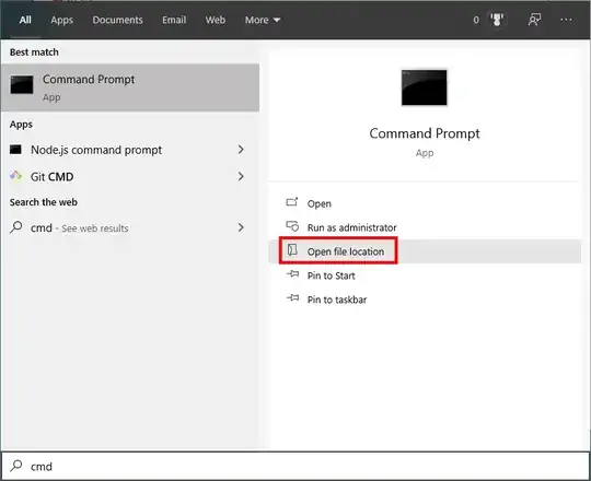

Step 1: Open CMD file location
Step 2: Right click properties on Command Prompt, and set favorite shortcut like this:
